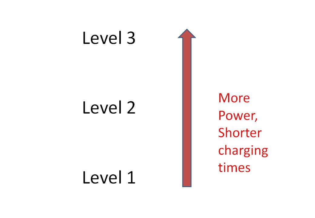

Answer: Level 3 charging is one level higher than level 2 charging. Level 2 Charging is AC while level 3 is DC.
Right?
Wrong.
According to the SAE, level 3 charging doesn’t imply DC. It can be either AC or DC.
“Levels” are indicative of the charging power. The higher the level the higher the power whether it is AC or DC.
Most people refer to AC EVSE’s (Electric Vehicle Service equipment) as “chargers” but technically they are not chargers.
The charger is actually on board the vehicle. The on-board vehicle charger converts AC current to DC current since electric vehicle batteries are DC. The EVSE is the little box on the wall of your garage (generally 240 volts), or the portable unit that lives in the trunk of your car (generally 120 volts).
These EVSEs are an intermediary between your vehicle and the outlet in your home. The EVSE “talks” to your car and determines things such as what the maximum charging power the car will take and whether there is proper grounding.
Getting back to charging levels, there are no SAE level 3 charging specifications defined. Level 3 is TBD (to be determined).

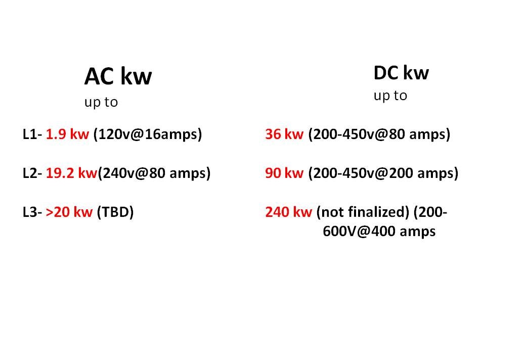

The following SAE chart is a great reference for the details of all the different AC and DC charging levels.
The maximum power level for each level is summarized in the following chart.

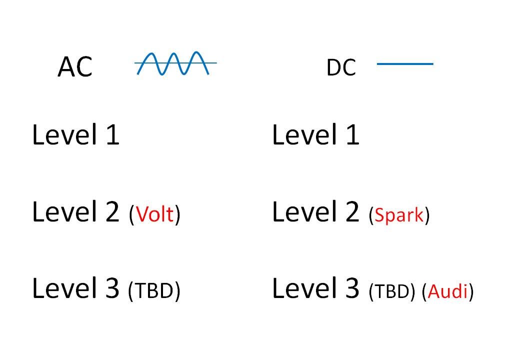

AC chargers generally use household AC power (either 120 volt or 240 volt). Level 1 AC is 120 volt and level 2 is 240 volt. The maximum power you can get with a level 1 charger is 1.9 kilowats. That is the power you will get from your portable 120-volt AC EVSE. It is set by the maximum current available out of a 20 amp 120-volt wall outlet.
Stepping up to level 2 AC charging, we are at 240 volts and a maximum of 19.4 kw which corresponds to 80 amps. Most plug-in hybrids will accept level 1 or level 2 AC – not level 3.
The Chevy Volt’s AC on-board charger is 3.3 kw level 2. The Chevy Spark EV’s level 2 charger is also 3.3 kw while the Nissan Leaf is 6.6 kw. Note that these vehicles are not pushing to the high end of level 2. The high end of AC Level 2 (19.2 kw) is usually for a pure battery electric vehicle like a Tesla.
There is a level 3 AC category which would be higher than the level 2 maximum of 19.2 kw but this category is currently undefined.
DC chargers do not reside in the vehicle as AC chargers do. The charger is contained in the large cabinet to which the charging cord is attached. Level 1 DC goes to a maximum of 36 kw. Level 2 DC goes to a maximum of 90 kw.
Currently level 2 DC is the highest level defined by SAE specification at 90 kw. Anything higher than 90 kw falls into level 3 which is TBD. However the preliminary upper limit is 240 kw.

A great and timely article. It's very useful to see the CCS charging specification chart.
Tesla's top charging rate is actually up to 135 kW today and they have hinted they may move to 150 kW in the not too distant future. They are experimenting with installing water-cooled cables on some stations which allows for thinner and more flexible cables that have less copper (or aluminum?) in the cable wiring.
The original CHAdeMO DC charging was limited to 500V at 125A for 60 kW but there are now a few stations capable of 500V at 200A for 100 kW. The Kia Soul EV is apparently capable of charging at an eventual peak rate of 68-70 kW on a 100 kW CHAdeMO charger. It will be interesting to see what GM announces for the Bolt DC charging specs in January at CES. My guess is they will support the 90 kW CCS spec mentioned in the article.
The real limiting factor for Bolt-sized battery is probably not the peak total combined kW rate but the amperage rate since initial charging on an empty battery is typically well below 400V. During the charge, the actual voltage being used will slowly rise as the battery fills up and the current will gradually go down if the battery needs to limit the incoming power. So, even the "90 kW" CCS might start out limited by the charger's amperage capability to 350V at 200A for 70 kW where a Tesla supercharger can support well past 300A and can immediately start charging a Model S 60 kWh battery at around 100 kW briefly and then at 85-90 kW for quite a while because the total charging rate is limited by the car and its battery's charging limits rather than being limited by the charger's 200A CCS limit.
I'm guessing the new CCS coalition aiming for 150 kW charging is just moving the spec to be 500V at 300A. While that's a benefit for a 90 kWh Audi car in a few years it could also be a benefit for a 55-60 kWh Chevy Bolt if it turns out to allow for faster initial charging by allowing a Bolt to start off charging at 350V at nearly 300A instead of 350V at 200A.

Most Ev batteries are 370V. I suspect that stays so because higher voltages results in more expensive isolation requirements and more expensive inverters.
To charge L3 DC at 240kW means a current of (240000/370=) ~650A . That is a lot of current requiring thick cables! For comparison: large homes are currently fused at 200A@220V. The battery can probably handle it, as the discharge current of a Tesla is even higher. Regenerative braking in the Volt charges the small Volt battery at up to 50kW, so a 7x larger Tesla battery should easily handle 7x as much power which is over 250kW.
I do wonder how the high currents affect the loss in the cables and batteries. Generally haste is always waste, and loss goes up worse-than-linear with current. Volt charge loses are about 18% toi ehat in the battery, cables and charger. Supercharging will make this likely worse, and that must affects the miles/kWh (MPGe) rating negatively.
At ~4% internal loss in the battery cells, a 240kW charge would generate 10kW waste heat. The battery chiller must work hard to haul that heat out so the temperature stays below 30C.
