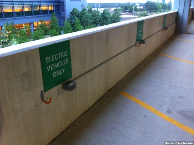

My suggestion? Have them install a line of exterior 120V outlets with appropriate covers. they could end up installing 10-15 outlets for the cost of a single Chargepoint, then no one will be fighting for the plug. How do you determine the rate? There is not a good exact way to do this, without metering every plug, and having a lockbox that only one person can get into (reserving a space). I would state something like "The average driver travels about 14k a year. Assuming they charge 75% at home (reasonable assumption), that amounts to 10,500 miles a year. The Volt sticker is 35 kWh/100 miles. That means the average tenant is going to use 3,675 kWh per year to charge. Multiple that by the rate (maybe that is 12 cents?) and you get $441 a year. Divide by 12. You'll write them a check for $37 a month for the opportunity to charge.
It isnt exact. But even if they end up undercharging you a bit, or overcharging someone, it won't be much.
I am just now starting to get this philosophy through the administration at the university I work at. It has been a long battle, but they are finally seeing the light. If you want to discuss this in detail, I would be happy to speak with you on the phone. Just send me a PM with your number.
I am attaching an image from a forum member that works at BP. This is what you should be going for. Eventually there is going to be a lot more EVs in your area, you will be fighting for charging, and the condo is not going to spend 10k everytime someone has a new car. Best to adopt a scalable platform.
