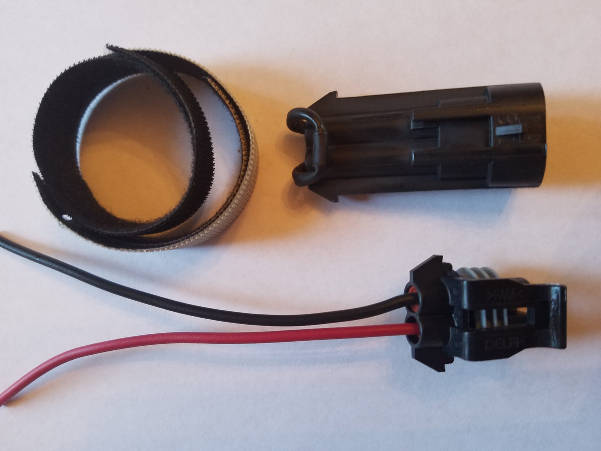

I'm in the UK, just got the SHVCS code(s) on my 2012 Ampera. Is the defeat plug still available for purchase? Thanks.
6 Posts
Thanks, yes I saw that page. There's no contact details at all shown and thought it a bit iffy just making payment to an unknown source. Have you dealt with the site?
6 Posts
Made my own defeat plug and used ODB2 but can't clear the codes which are latched. I have a VCX Nano which I connected and used GDS2 which also didn't clear the codes so I'll have to reprogram the HPCM2 module. It seems the ACDelco page has changed as it now says it doesn't support Vauxhall/Opel programming which may be a problem for my 2012 Ampera
