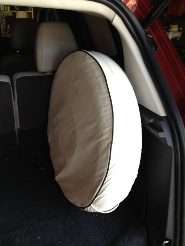

For my CMax, I got a matching cover that are used to protect RV or trailer wheels from the sun when not in use.
Got it on Amazon. http://amzn.com/B0015Y9358
