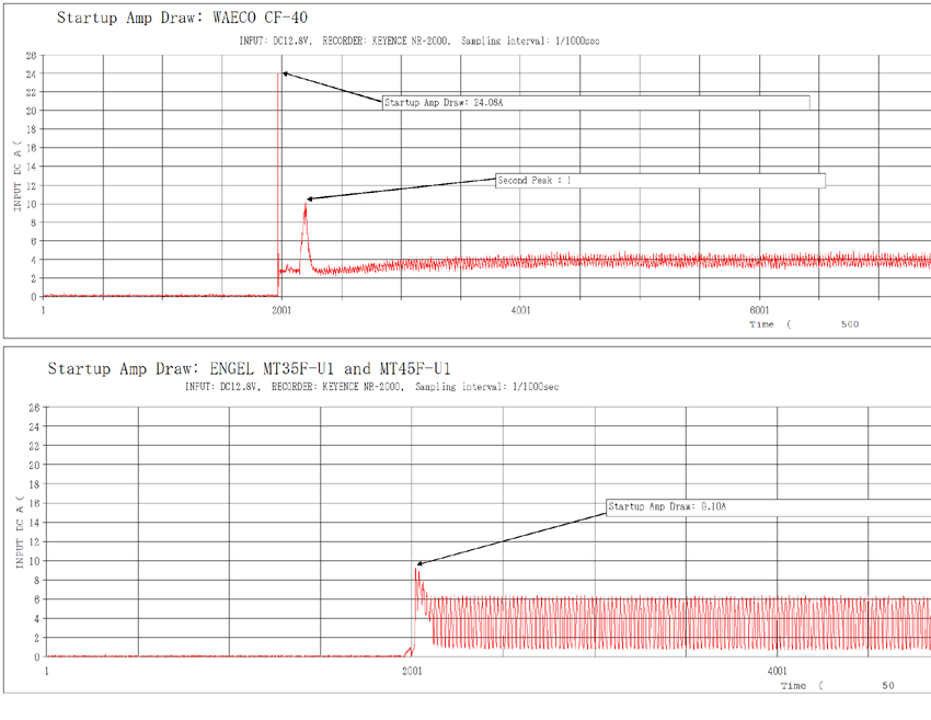

As others have said, don't even think about drawing 27AHr (300WHr) from the 60AHr AGM battery. And since it's a compressor, there will be a large turn on surge.
Start-up surge is 8A for the Engel.
