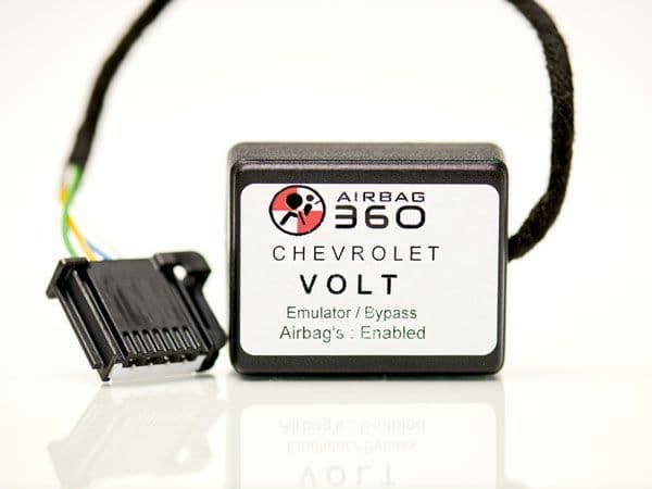

I'm fed up with the issue and just want to find a way to bypass the passenger presence sensor somehow, is there a transistor of some sort that I can add to the sensor plug, to trick the system into thinking noone ever seats in the seat?

Of course it really isn't safe to defeat or tamper with the airbag system's operation.
