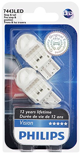

Which bulbs did you use? They seems quite a bit brighter than the OEM bulbs. I did this same upgrade but used the Phillips led bulbs and they don't seem much brighter at all.

17 Posts
Discussion Starter · #14 ·
Like others, I too, used the Philips 7443 Red Vision LED Stop/Tail light (Pack of 2)
In person, the color difference is more apparent than the brightness—the philips bulbs are red LED's, compared to clear bulbs under a red lens.

1,680 Posts
Is it better to use red LEDs or clear LEDs for the brake lights?
Red.
I just bought a pair of Philips 7443s today. Going to install them over the weekend.
