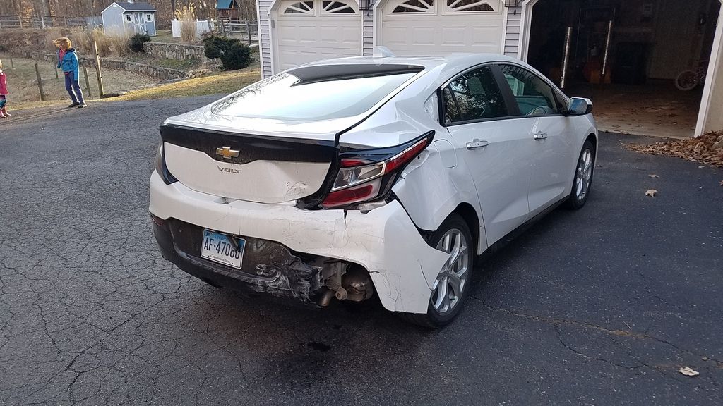

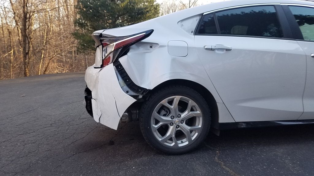

Hi Tom, I forgot I had a photobucket account. I drove the car the 10 miles (or so -- takes 10 minutes over roads at 25mph; so maybe 5 miles) home from the location where I got hit. Here are some pictures:
If they total the car, I wouldn't get enough to buy the same one. I could only afford this one because I bought it with 20% off. I also don't get much or any of the Federal tax rebate, so it really doesn't pay for me to buy another Volt.

Doesn't
look all that serious from these pics. I would try to charge it, probably will run fine until you can get it in for body work.

13,358 Posts
You won't find the tractoin battery in the hatch anyway, the only thing there is the 12V battery. Look underneath the car in front of the rear wheels. There should be a T shaped battery between the wheels and along the center console area. From the looks of the pictures, don't see anything obvious that shows the battery is damaged. if anything, you should get under the rear passenger side to see if there is any damage to the fuel tank.
I hope it's not totaled, but only a body shop can tell you. I'm not qualified.

389 Posts
I wouldn't be worried about the battery from what I can see. It's buried way down and forward of the damage. Does the car still track straight on the road? I'd be more concerned about the entire car being a bit tweaked out of square.

Discussion Starter · #14 ·
I think it tracks OK, but I drove it on very windy, narrow roads (New England) to the body shop. There are almost no straight line roads on the route we took. To me, it seems as if the driving is OK, though.

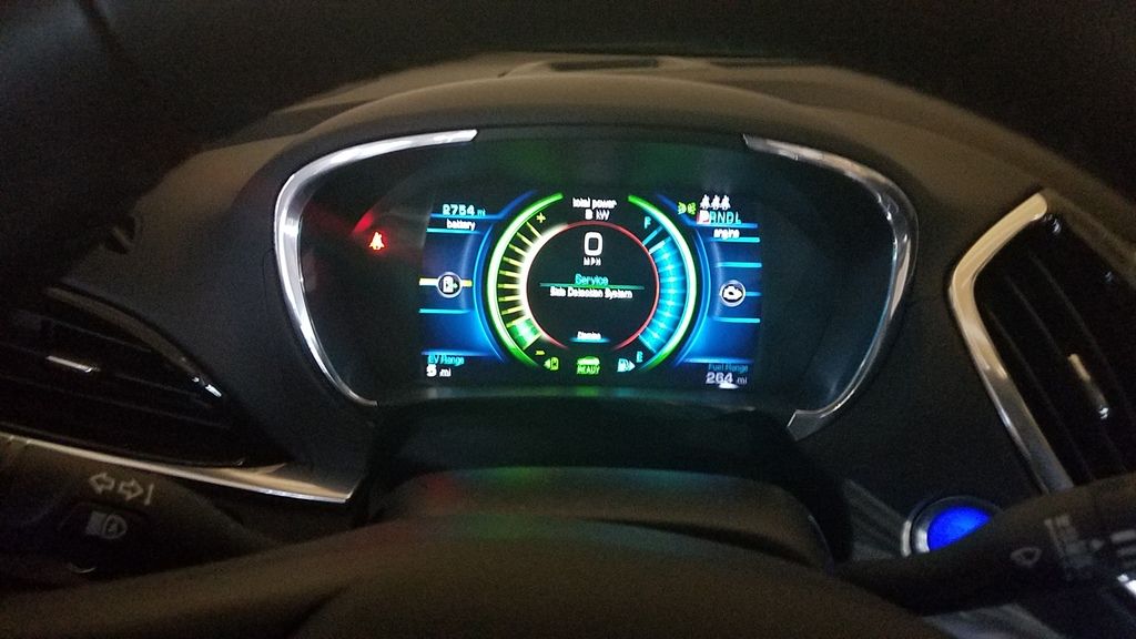

In the pic you posted, what does the service message say?
Looks like S^* S())(*) System" or something like that.. Interested in what it says..
