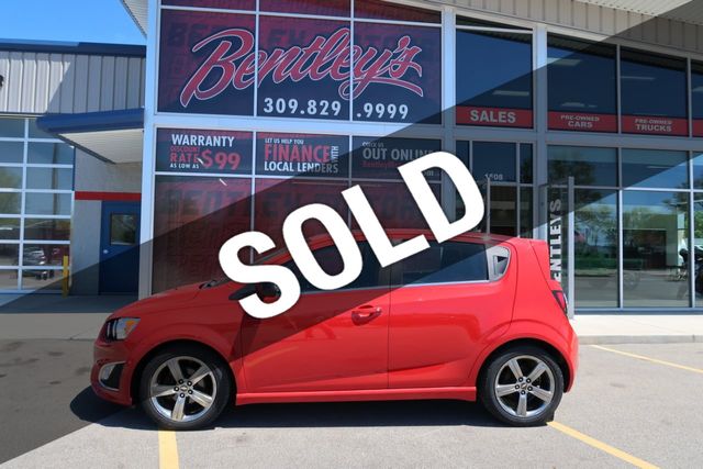

Sonic is a fun little car also. We had one with the 1.4 turbo and a tune. Very quick and good handler.
