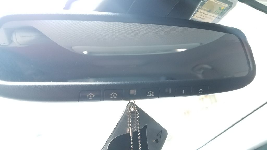

Well I thought it was weird that my 2018 Volt didn't have homelink while my 2000 Grand Cherokee and 13 Mustang GT/CS did but no big deal. What did annoy me was not having an autodimming rearview. Even my 94 Mustang has one. So I found a homelink/Autodimming mirror on ebay with that harness for 40 bucks shipped. Problem solved now. Installed it and wired it in about 20 minutes. Tapped into the wiring for the overhead console so it was super easy. Now it feels like its supposed to, Modern...

And for anyone wondering. Not having an existing auto dim mirror is not an issue. Switched power, constant power and ground are all easily available from the overhead console.
