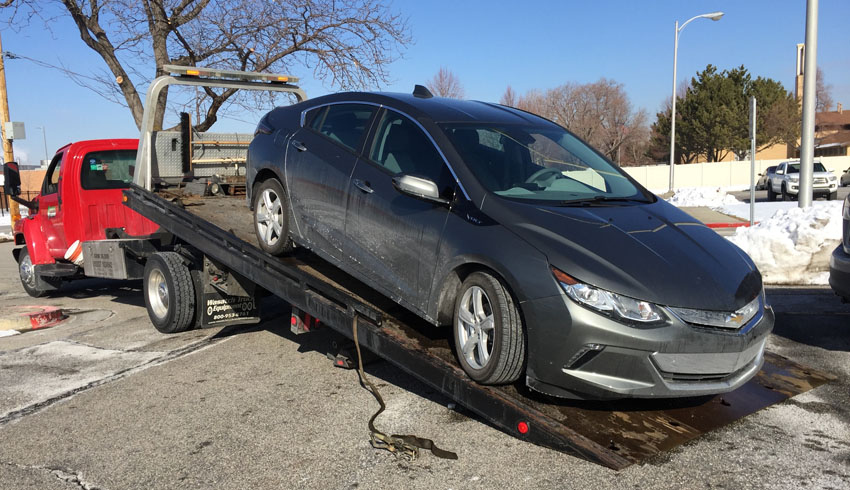

Car has just over 2K miles on it. I've been driving it about a week. I went to a meeting, and it ran fine. Then came out to the parking lot and it's not going anywhere. "Shift to park" was displayed. Called OnStar, and was towed...
I figured I'd post up so that other people would be aware. It's currently at the Dealer. I have no idea what happened at this point.
