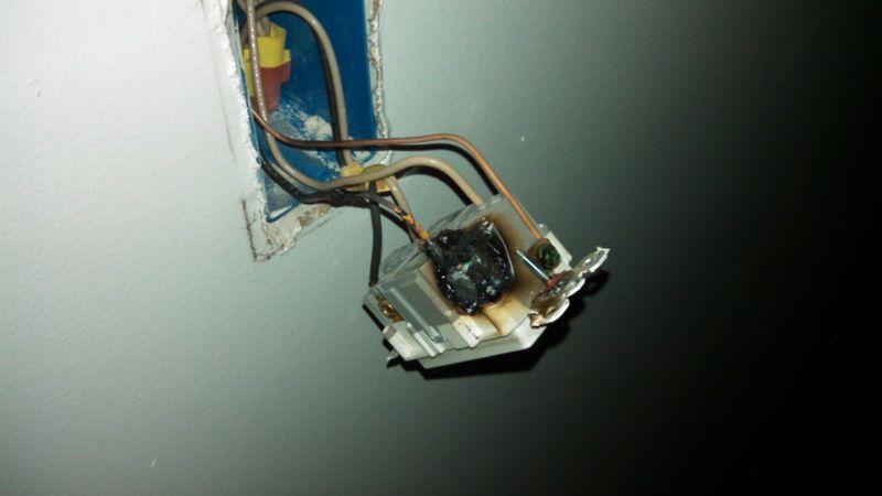

Not to be an alarmist, but this is what can happen if you have something else on the same circuit.
This was 100% my fault. But clearly shows what can go wrong if your not diligent.
That looks like a bad connection that caused a higher resistance and subsequent heat build up. Those outlets should be fine with 15a or 20a (depending on your breaker). But...I guess it wasn't...my feeling is one of the stab-in terminations just didn't have enough contact. This is why the lawyers at GM default to 8 amps.
Note back stabs were used in the above. Check to make sure the screw terminals are used instead.
